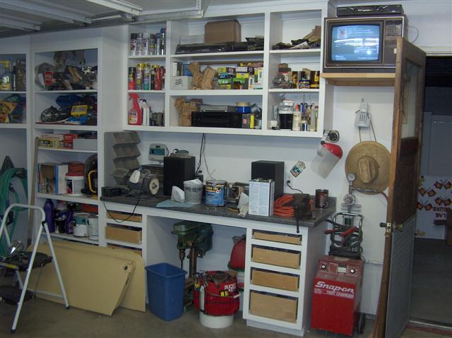

Here is a picture of my unfinished garage cabinents; (IMG:http://www.914world.com/bbs2/html/emoticons/biggrin.gif)
