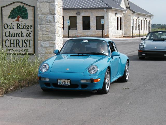

Mexican Blue aka: Riviera Blue, Im gonig to smooth out the top, and paint both valances and rockers the same color too (IMG:http://www.914world.com/bbs2/html/emoticons/smile.gif)

Lou W   Mexican Blue aka: Riviera Blue, Im gonig to smooth...   Jan 12 2006, 09:47 PM
Aaron Cox     Jan 12 2006, 09:51 PM
Lou W
  Jan 12 2006, 09:53 PM
