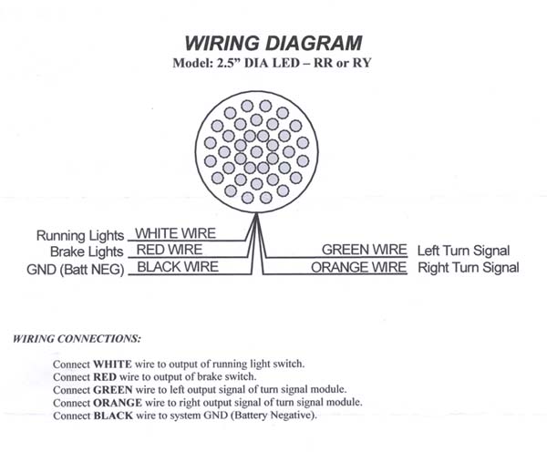

I tested the LED light and they are fantastic! I'm really glad I found these plug and play, they eliminate alot of work. Well actually I still need to mount them. If I epoxy them in I won't be able to use the existing mount screw since the disc covers it. I "may" epoxy it to a metal bulb cap so I can mount it like a standard bulb. I like the left and right signal feature but will probably combine them for one ring. The flashing stop for a few seconds is a great modern feature!
