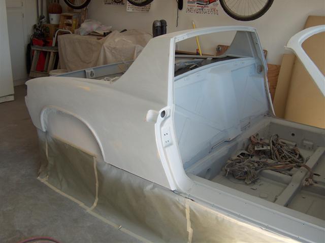

Lou W   Here are some shots after the top side was primere...   Jan 12 2006, 09:32 PM
Lou W   another;   Jan 12 2006, 09:32 PM
Lou W   again;   Jan 12 2006, 09:32 PM

Lou W   Started the final block sanding today, I'm usi...   Jan 16 2006, 07:03 PM
Lou W   Another;   Jan 16 2006, 07:04 PM
Lou W   Driver side rear panel;   Jan 16 2006, 07:04 PM
Lou W   again;   Jan 16 2006, 07:05 PM
Lou W   Nice and smooth;   Jan 16 2006, 07:05 PM
Lou W   Rear trunk;   Jan 16 2006, 07:06 PM
Lou W   Next, I will shoot a couple more thinned down coat...   Jan 16 2006, 07:07 PM
Lou W   Then, I'll finsh with 500 grit, before applyin...   Jan 16 2006, 07:07 PM
