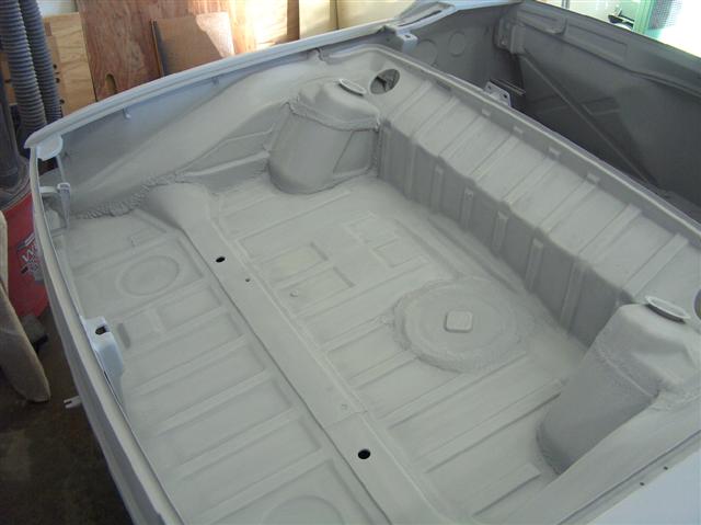

Lou W   Here are some shots after the top side was primere...   Jan 12 2006, 09:32 PM
Lou W   another;   Jan 12 2006, 09:32 PM
Lou W   again;   Jan 12 2006, 09:32 PM
Lou W   Front trunk and Tank area;   Jan 12 2006, 09:33 PM
