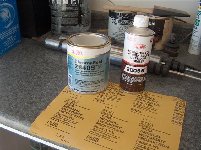

Then, I'll finsh with 500 grit, before applying the sealer;

Lou W   Next, I will shoot a couple more thinned down coat...   Jan 16 2006, 07:07 PM
Lou W   Then, I'll finsh with 500 grit, before applyin...   Jan 16 2006, 07:07 PM
