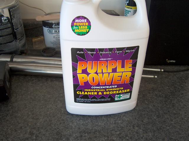

I started cleaning the latched and catches, I used this, I let the parts soak for about an hour, then I scrubbed them with a parts brush, and rinsed them off and applied light oil to prevent rusting. It really worked well;
