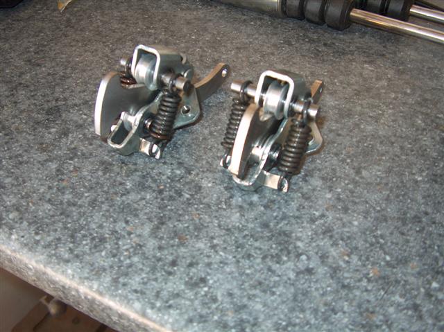

Lou W   I started cleaning the latched and catches, I used...   Jan 16 2006, 07:10 PM
Lou W   I bought Engmans Stainless Steel Door Straps, and ...   Jan 16 2006, 07:12 PM
Lou W   They cleaned up pretty good;   Jan 16 2006, 07:13 PM

Lou W   After taking the door strap assembly apart, and se...   Jan 16 2006, 07:24 PM
