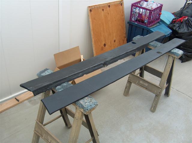

I started to work on the rocker panels that I bought from Dave (Korijo). First I stripped them with paint remover;

Lou W   I started to work on the rocker panels that I boug...   Jan 23 2006, 12:05 AM
Lou W   another;   Jan 23 2006, 12:06 AM
Lou W   I had to do a little bit of fiberglassing;   Jan 23 2006, 12:07 AM
Lou W   I filled in the holes for the jack posts, I'm ...   Jan 23 2006, 12:09 AM
