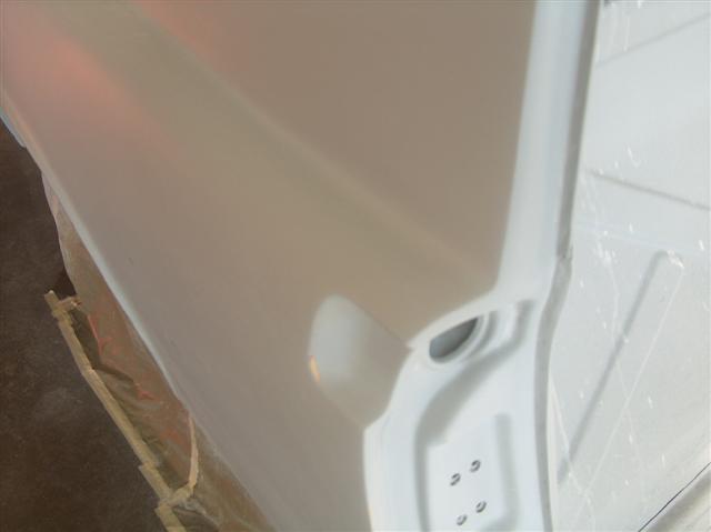

Lou W   I shot the final coat of primer last week, so now ...   Jan 23 2006, 12:12 AM
Lou W   Here's a better picture;   Jan 23 2006, 12:13 AM
Lou W   Close up;   Jan 23 2006, 12:13 AM
Lou W   Right rear quarter;   Jan 23 2006, 12:14 AM
Lou W   Passenger front;   Jan 23 2006, 12:15 AM
Lou W   After I get the rest of the car blocked, hopefully...   Jan 23 2006, 12:16 AM
