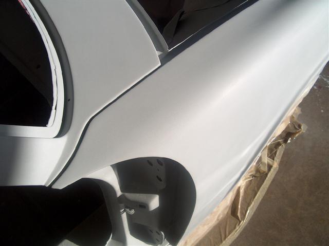

Lou W   Right rear quarter;   Jan 23 2006, 12:14 AM

Lou W   After I get the rest of the car blocked, hopefully...   Jan 23 2006, 12:16 AM
