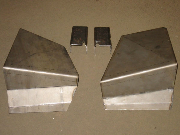

I have one set of these parts in stock.
Add a tubular brace from the inner console to the firewall and you won't ever have cracking problems with the rear suspension pickups.

Racer Chris   Andrew, The "buckling" you noted is nothing but a ...   Mar 22 2006, 06:45 AM

Racer Chris   Here's what I worked out for the outer console...   Mar 22 2006, 07:30 PM
Andyrew   Thanks Chris! I'll do that.. looks strong...   Mar 22 2006, 07:31 PM
Racer Chris   I have one set of these parts in stock. Add a tubu...   Mar 22 2006, 07:32 PM
Andyrew   Checked your site, Didnt see a price. I dont have...   Mar 22 2006, 07:39 PM
Racer Chris   Cracking in this area is primarily due to repeated...   Mar 22 2006, 08:03 PM
