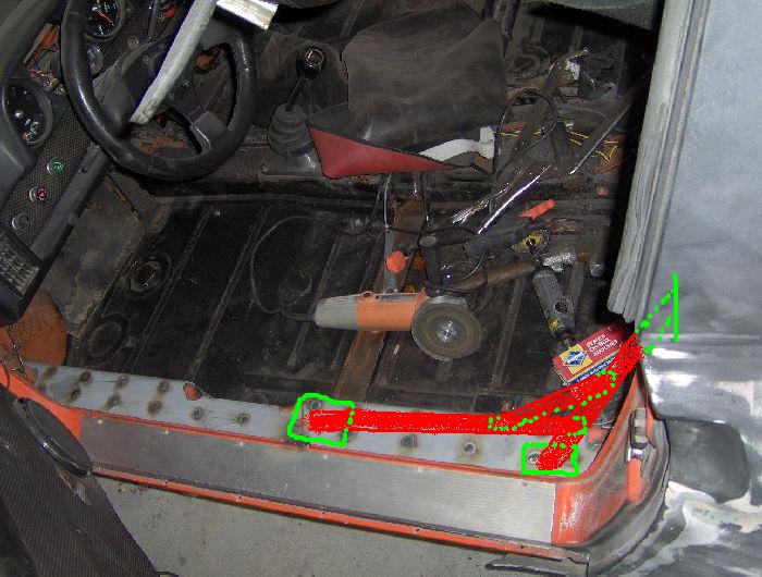

Heres a pic of what im planning for the interior.
Its just a tad bit of help for structure, wont hurt my seating, and maybe help if I get T boned, I know, wont do a bunch.. but I think it may help the chassis.

Andyrew   Heres a possibility.   Mar 22 2006, 07:28 PM
Racer Chris   Here's what I worked out for the outer console...   Mar 22 2006, 07:30 PM
Andyrew   Thanks Chris! I'll do that.. looks strong...   Mar 22 2006, 07:31 PM
Racer Chris   I have one set of these parts in stock. Add a tubu...   Mar 22 2006, 07:32 PM
Andyrew   Checked your site, Didnt see a price. I dont have...   Mar 22 2006, 07:39 PM
Racer Chris   Cracking in this area is primarily due to repeated...   Mar 22 2006, 08:03 PM
Jeroen   Andyrew, The blue tube in your sketch won't do...   Mar 22 2006, 08:07 PM
Andyrew   Thanks Chris, That helps! That is exactly ...   Mar 22 2006, 08:08 PM

Andyrew   Jeroen, Sorry didnt see your post... I didnt know...   Mar 23 2006, 12:53 AM
Andyrew   Heres a pic of what im planning for the interior. ...   Mar 23 2006, 01:06 AM
Porcharu   [QUOTE=Here's an example of the tubular brace ...   Mar 23 2006, 02:15 AM
dan10101   That tube brace will fold just as quickly as the s...   Mar 23 2006, 03:00 AM

Racer Chris   ...   Mar 23 2006, 06:12 AM
Jeroen   andyrew, the pic below shows 2 situations in the t...   Mar 23 2006, 08:37 AM
maf914   Andyrew, You might want to go back and check out ...   Mar 23 2006, 10:28 AM

Aaron Cox   stop pussyfooting and do a real doorbar <...   Mar 23 2006, 12:20 PM
Andyrew   Helps getting in andy. Getting out is just a matt...   Mar 23 2006, 12:23 PM

Pistachio   Re: the dog-ear tube braces What's the "desire...   Mar 24 2006, 09:15 AM
