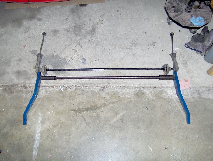

So my project for a stronger chassis has begun.
Heres were Im at right now. Took the suspension out today.
I'll go do some welding and prep tonight, hit the bed, see what you guys say, and do some more welding tomorrow.
(IMG:http://www.teamgracer.com/cars/914club/914v8/914-8%20suspension-003.JPG)
Picture of some buckling of the suspension. Other side has a raised area, but is generally flat, this side has raised and concave area's. I'll be adding something here for strenthening, a tube? A flat piece of metal? A triangle?
(IMG:http://www.teamgracer.com/cars/914club/914v8/914-8%20suspension-004.JPG)
(IMG:http://www.teamgracer.com/cars/914club/914v8/914-8%20suspension-005.JPG)
(IMG:http://www.teamgracer.com/cars/914club/914v8/914-8%20suspension-006.JPG)
Here is some area's im going to weld, any two pieces joined together I will stitch weld.

Racer Chris   Andrew, The "buckling" you noted is nothing but a ...   Mar 22 2006, 06:45 AM

Racer Chris   Cracking in this area is primarily due to repeated...   Mar 22 2006, 08:03 PM
Jeroen   Andyrew, The blue tube in your sketch won't do...   Mar 22 2006, 08:07 PM
Andyrew   Thanks Chris, That helps! That is exactly ...   Mar 22 2006, 08:08 PM
