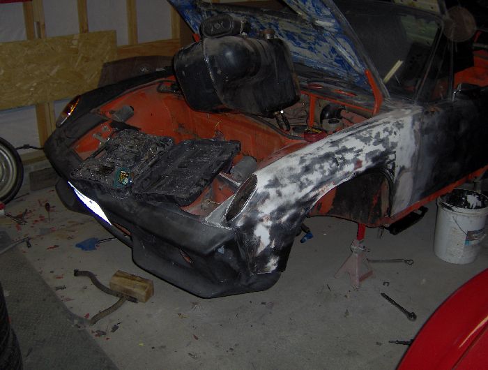

pic of car

dan10101   That tube brace will fold just as quickly as the s...   Mar 23 2006, 03:00 AM
dan10101   pic   Mar 23 2006, 03:03 AM
dan10101   pic of car   Mar 23 2006, 03:03 AM
dan10101   sway bar hole a tad small. Need to enlargen and re...   Mar 23 2006, 03:04 AM
