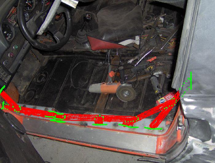

re: doorbar design
remember that the middle of the long is it's weekest point taking stress away from other parts of the chassis and focusing it to the middle of the long (as in your sketch) might not be a good idea
Thanks, That helps a bunch!
Also I'll move the pickup points further.
How bout this?

Racer Chris   Andrew, The "buckling" you noted is nothing but a ...   Mar 22 2006, 06:45 AM

Racer Chris   Cracking in this area is primarily due to repeated...   Mar 22 2006, 08:03 PM
Jeroen   Andyrew, The blue tube in your sketch won't do...   Mar 22 2006, 08:07 PM
Andyrew   Thanks Chris, That helps! That is exactly ...   Mar 22 2006, 08:08 PM

Andyrew   Jeroen, Sorry didnt see your post... I didnt know...   Mar 23 2006, 12:53 AM
Andyrew   Heres a pic of what im planning for the interior. ...   Mar 23 2006, 01:06 AM

Jeroen   andyrew, the pic below shows 2 situations in the t...   Mar 23 2006, 08:37 AM

Aaron Cox   stop pussyfooting and do a real doorbar <...   Mar 23 2006, 12:20 PM
Andyrew   Helps getting in andy. Getting out is just a matt...   Mar 23 2006, 12:23 PM
