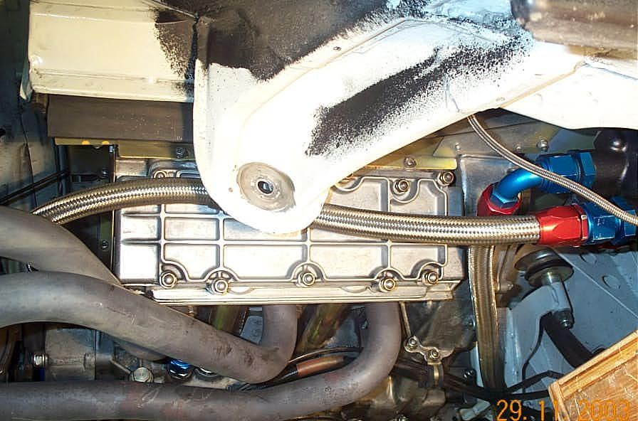

I don't have any good pictures of the welding done on my car.....this one is prolly best. The factory welding(to use the term loosly) in this area is gawd awful. I had to spend hours grinding out the cold lap & porosity....amongst other flaws.
I also welded around the perimiter of the ear & ground it shooth. The same with the arch at the wheel well.....after grinding the ends of the lap even....then ground that smooth. On both of these areas, there were spot welds that blew out the edge of the material. IIRC, most of the rest was more seal welding than anything that would add much strengh.....tho I could be wrong.
Unibodies are designed to be assembled using the quickest method that *will suffice*. As to wheather this is the strongest method is for you to decide. This thing sure as hell wasn't designed to cope with what I'm doing to it.
