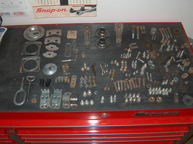

Another view, some of them look a little rusty, I dipped everything in Vineger and then I'll get them beed blasted before platting;

Lou W   Getting the nuts and bolts ready to get plated, I ...   Apr 3 2006, 11:46 PM
Lou W   Another view, some of them look a little rusty, I ...   Apr 3 2006, 11:47 PM
