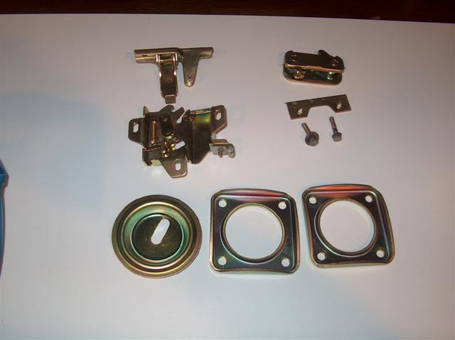

Here's a picture of a couple parts that I bought from Bruce (he's a member here), they did a very good job plating these;

Lou W   Here's a picture of a couple parts that I boug...   Apr 3 2006, 11:49 PM
