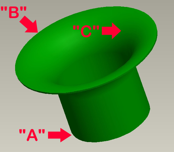

> Volocity stack design considerations??, for my mickey mouse ITB's

Slightly warmed up /4 motor applications...I'm thinking just about any design better than none at all....I'd like to metal spin these myself, however if I can get a good price on 8 from a fellow non-club member, I'll go that route (IMG:http://www.914world.com/bbs2/html/emoticons/smash.gif)

Andy,
One end of the axle is done, just need to do the other one, tonight I'll try to get it done. Diameter is critical.....
Paul,
I can send you a real drawing if I can get my computer from crashing due to new video card (IMG:http://www.914world.com/bbs2/html/emoticons/headbang.gif)
So far...
"A"...minimum ID to be 47mm, max OD 55mm (I doubt you'd use .156 or thicker material (IMG:http://www.914world.com/bbs2/html/emoticons/smile.gif) )
"B" 90mm before overlapping
"C" whatever R is easy for you, nice big one will work for me (IMG:http://www.914world.com/bbs2/html/emoticons/smile.gif)
Overall height, I'm thinking somewhere between 2" and 3" due to aircleaners, unless I can find a nice tall aircleaner (something smaller than the 9" units I've seen at the bug places)

Thorshammer   The outer lip needs to be rounded. The edge is ver...   Apr 4 2006, 09:05 PM
retrotech   I tested air flow with vacume cleaner suction & sm...   Apr 4 2006, 09:48 PM
Twystd1   YUP... What everybody else said about the rounded ...   Apr 5 2006, 12:43 AM
