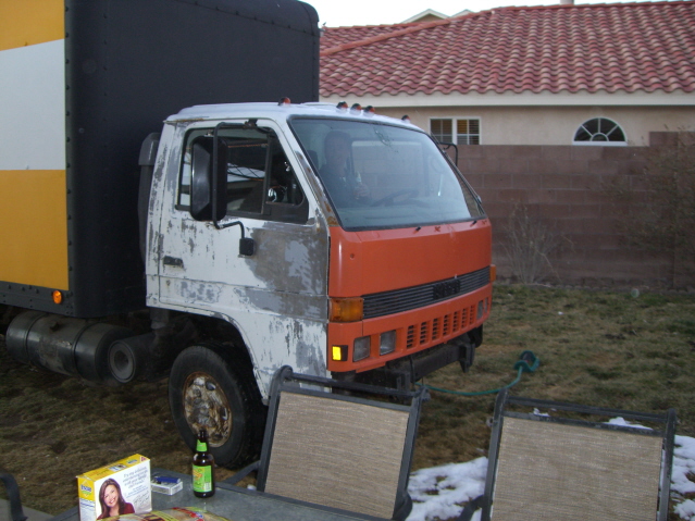

C'mon Joe, let's paint the cab of your truck..

....not that it needs it....I'll bring a roller!
