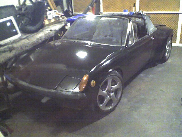

A bat out of hell.
Posts: 3,944
Joined: 31-January 05
From: Hercules, California
Member No.: 3,533
Rustoleum Paint Code #7779. Glosss Black.
Still needs to be finished with the super fine paper but I'm happy so far.

QUOTE(Dr. Roger @ Feb 23 2007, 01:25 PM) *
I have heard that black is difficult. I was curious about how black would work. I am doing a rustoration on a black car. I am concerned about the mounting costs and this idea has some appeal. I hope you will keep us posted on your black car. If some issues come up, it will be very helpful to know before I jump into this. My cat wont be ready until late Spring or early summer.
The cost savings is very nice. The amount of work may be more. However if you are doing BC CC then maybe there is not more work. Both methods require a lot of wet sanding. What about doing a clear coat on top of this paint?

QUOTE(Bartlett 914 @ Feb 23 2007, 05:21 PM) *
I own 3 black cars & all show every flaw w/ such precise detail it's a wonder why I put up w/ them. Black is by far the toughest paint to get to look good... sprayed. I immagine it's just as tough to get to look good rolled on as well. (IMG:style_emoticons/default/cool_shades.gif)
