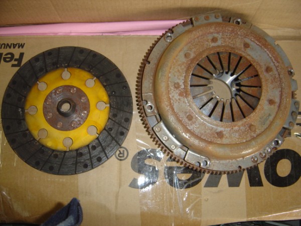

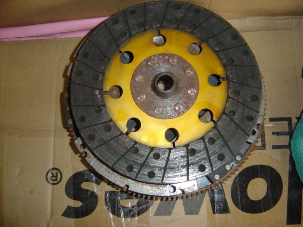

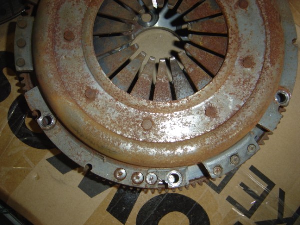

Well, I just got off the phone with Kennedy and we couldnt figure out what PP and clutch this is that I took off the conversion in the car so I am going to box it up and send it to them for evaluation. I feel it is better to be safe than sorry. From my description to him he said it sounds like a stage 1 which will not handle the 327 I am building so he is going to check it out and make his suggestions which from past experience I will probably follow. Most likely I will wind up with the same one I put in the Chalon. It had the 228mm Kevlar Stage II and it held really good.
Here are pictures of the clutch and PP, if anyone knows or can tell from the pics what it is, let me know please.
