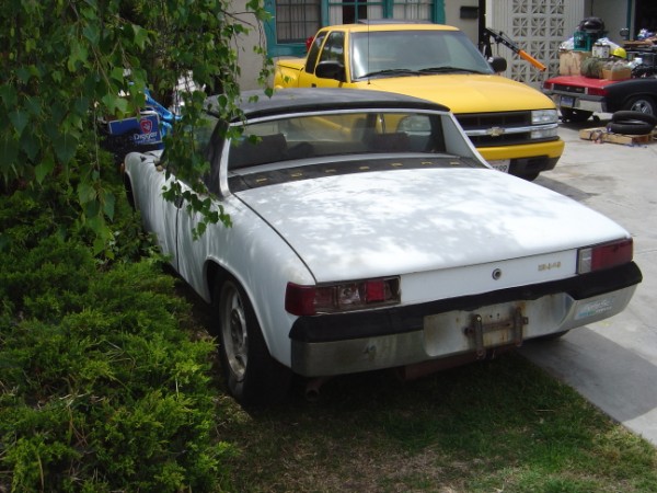

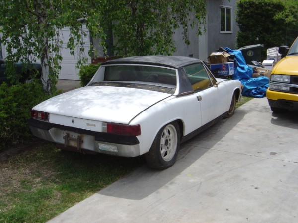

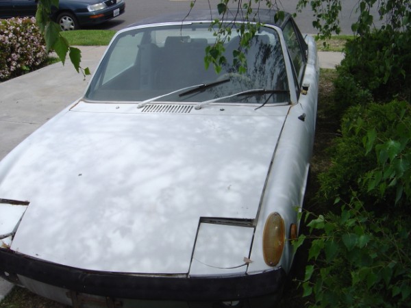

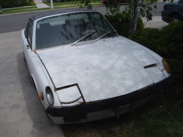

Here it starts, I spent about 5 years working on the last project car and it sold on Saturday and I took delivery of the new one the same day. It was someone elses project that had been sitting for years untouched. Here is what I know about the car so far.
One PO started building a Renegade V8 conversion on a 1975 914. Not sure why but he did a slant nose conversion on it, in steel of course and bought a Renegade conversion kit to do a V8. Apparently he never finished it as the last PO bought it and tried to find someone to finish it for him with no luck. The car has pretty much not changed since the first owner. As far as I know, the last PO had it for 3 years. Now I have it.
The car is missing a lot of small parts. Read that as so many I dont know where to begin. Door strikers, door handles, the only interior are destroyed white seats. No lower dash, top dash no good at all, no dash face, no pedal cluster, or shifter, no cables or partial cables, wiring pulled out most everywhere and not connected to anything. The engine and trans are mounted and a very old original RH radiator is sitting in front not really mounted. The gas tank just sitting there not connected to anything, no rockers or rubber. It's pretty much just a shell with an unknown engine and trans.
So here is where it begins:
Today, I sourced a 327 from a 68 Camaro engine casting number #3914678 which I will rebuild with a known configuration that I have used before. Thomas came by earlier and picked up my billet IM plate and HB gearset to install in the transmission. He left before the trans and engine were pulled. Jared was here helping me most of the day. We cleaned everything out of the car and then dropped the engine and trans and removed the radiator and hoses. The radiator looks brand new and never used. The engine and trans looked really clean underneath. The top looked like it was parked outside for the last 3 years, which is probably the case. Anyway, I wanted to find out what clutch and flywheel were used and what I was going to have to upgrade to meet my needs. I measured it and it is the 9" clutch and PP. I can use that for now. I am going to install the new RH radiator and fan setup and new marine exhaust hoses. Tomorrow I will finish removing the rest of removeable parts from the car and move forward with body work.
Did I mention there is no RUST in this car? However, I did find that both rear fenders were replaced at one time, the one on the drivers side rear was originally Yellow and the one on the passenger side rear was bronze I think. The front has taken a hit at one time too and the body work is not as good as the rear. I have my work cut out for me. With any luck, and time, I could get it close to running by the end of summer?
Here are some pictures of the car and what I did today.
