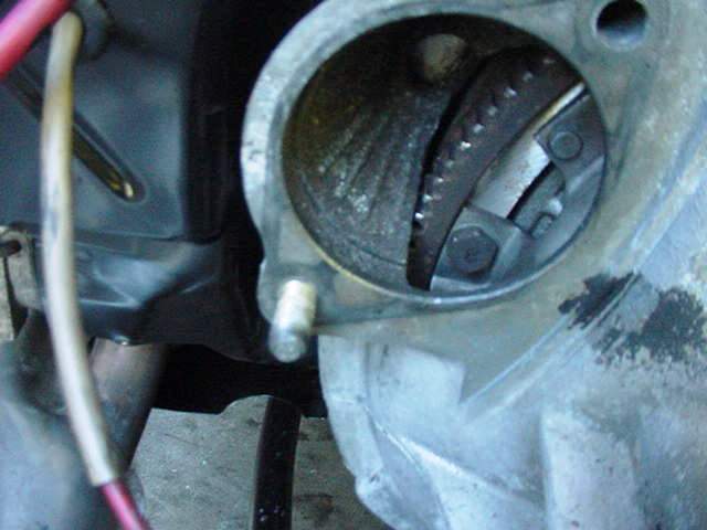

is the fw being this close to the bell housing on the trans the standard? if it's the diaphram unit is what's wrong and the fw is right i'd rather not have to pop the fw off.

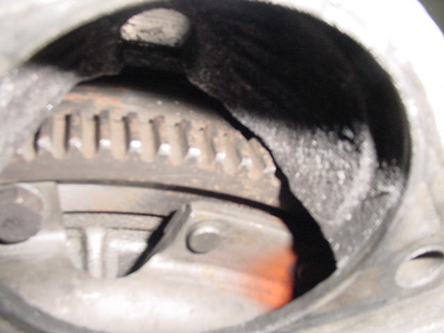

rhodyguy   HA! <_< while rotating the engine i note...   May 7 2007, 05:04 PM
SLITS   Now, the fact that it does rotate is REALLY GOOD N...   May 7 2007, 05:12 PM
rhodyguy   there is a tight .018" distance from the outs...   May 7 2007, 05:30 PM

rhodyguy   is the fw being this close to the bell housing on ...   May 7 2007, 07:49 PM
davep   I can't see anything bad there.   May 7 2007, 07:59 PM
So.Cal.914   Looks right to me also. Did you test the starter?   May 7 2007, 08:18 PM

SLITS   Kevin ..... I thought maybe you changed the flywhe...   May 7 2007, 09:04 PM
So.Cal.914   Nope, I think your right Ron. Looks bad to me also...   May 7 2007, 09:28 PM

rhodyguy   that fw is not the on that came with the engine. i...   May 7 2007, 10:08 PM
