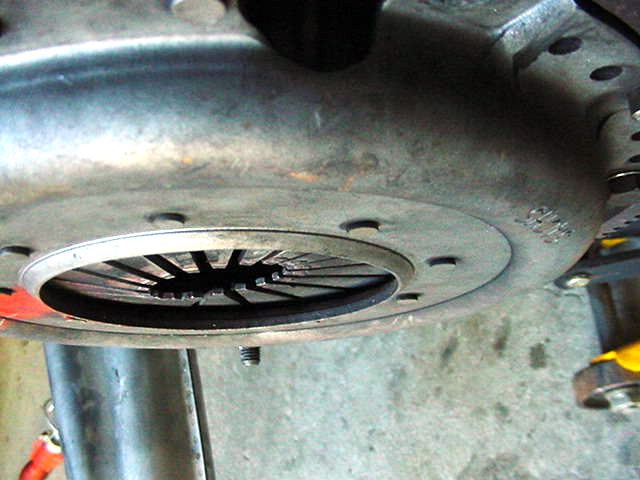

rhodyguy   is the fw being this close to the bell housing on ...   May 7 2007, 07:49 PM
davep   I can't see anything bad there.   May 7 2007, 07:59 PM
So.Cal.914   Looks right to me also. Did you test the starter?   May 7 2007, 08:18 PM
Aaron Cox   check this one out..... did you put a NEW oil pum...   May 7 2007, 08:20 PM
rhodyguy   <_< 215 vs 210? disc that came out is identi...   May 7 2007, 08:49 PM
Demick   Please tell me you didn't use this pressure pl...   May 7 2007, 08:58 PM
SLITS   Kevin ..... I thought maybe you changed the flywhe...   May 7 2007, 09:04 PM
So.Cal.914   Nope, I think your right Ron. Looks bad to me also...   May 7 2007, 09:28 PM

rhodyguy   that fw is not the on that came with the engine. i...   May 7 2007, 10:08 PM

davep   I don't like the look of the flywheel to crank...   May 8 2007, 09:52 AM
rhodyguy   new pivot bushing, clip, t.o. bearing were install...   May 8 2007, 10:16 AM
