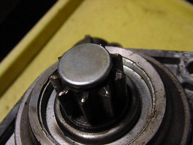

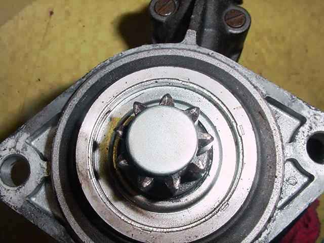

John   what about a pic of the starter?   May 7 2007, 10:18 PM
rhodyguy   i put this starter in during the wcc04' in the...   May 7 2007, 11:42 PM
John   Have you found any shiny spots where it was rubbin...   May 8 2007, 12:00 AM
