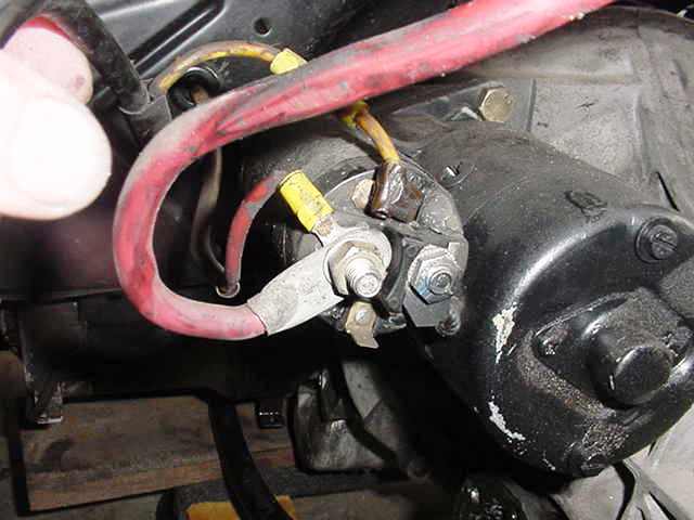

i took this before the old engine pull. i'll have to try the battry charger to energize the starter. red charger lead to the to the spade term for the yellow wire and the black chargr wire to nut with the wire that secures the wire that goes to the starter body. all it does is hum. are these the correct test points for the starter out of the car?
weird. the old setup workd just fine when i put the car away for its winters sleep. how the starter could go bad just sitting is beyond me. but then, quite a few things are.

QUOTE(rhodyguy @ May 8 2007, 09:13 AM) *
k
I would put the black wire from the charger to the frame where it bolts in. Put the red wire on the big red wire. Short from the yellow to the red to energize the starter. Not sure about the charger being big enough. Jumper cables from a good battery is a better power source.

echocanyons   :agree: Test the starter while out of the car....   May 8 2007, 11:02 AM

vsg914   use the jumper cable method to test everything wit...   May 8 2007, 11:54 AM
Travis Neff   I just did a bench test on mine, hook the positive...   May 8 2007, 12:33 PM
Twystd1   The problem probably isn't the starter section...   May 8 2007, 01:28 PM

Aaron Cox   your local FLAPS will test the starter for you.......   May 8 2007, 05:16 PM
Twystd1   The Flaps idea is a good one. There is one proble...   May 8 2007, 05:54 PM
