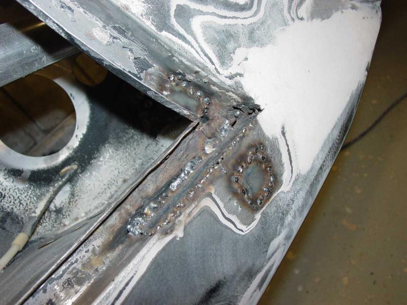

degreeoff   The next few pics are of the things I had to weld ...   Jun 15 2007, 04:59 PM
degreeoff   more.... :welder:   Jun 15 2007, 05:01 PM
degreeoff   1 more   Jun 15 2007, 05:02 PM

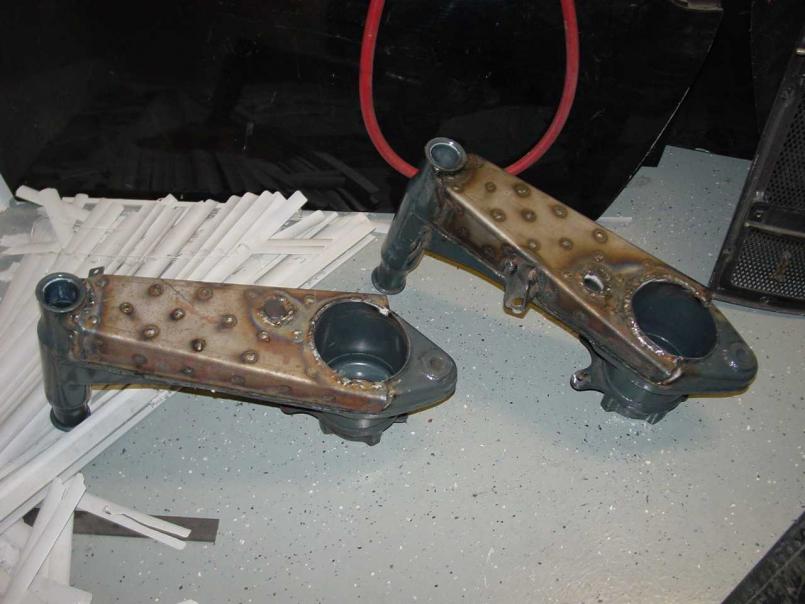

degreeoff   a few more of my rear end suspension bracing, hood...   Jun 15 2007, 05:10 PM
degreeoff   yet more....   Jun 15 2007, 05:12 PM
