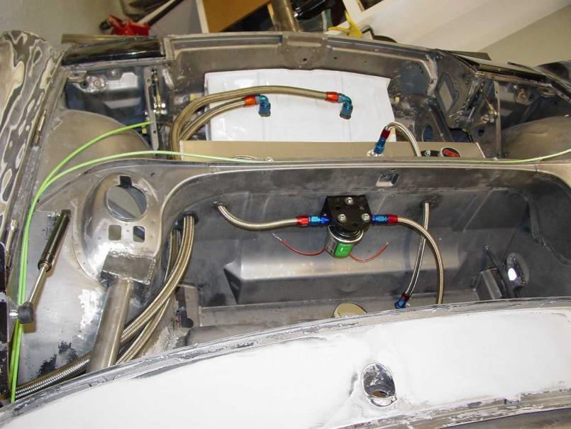

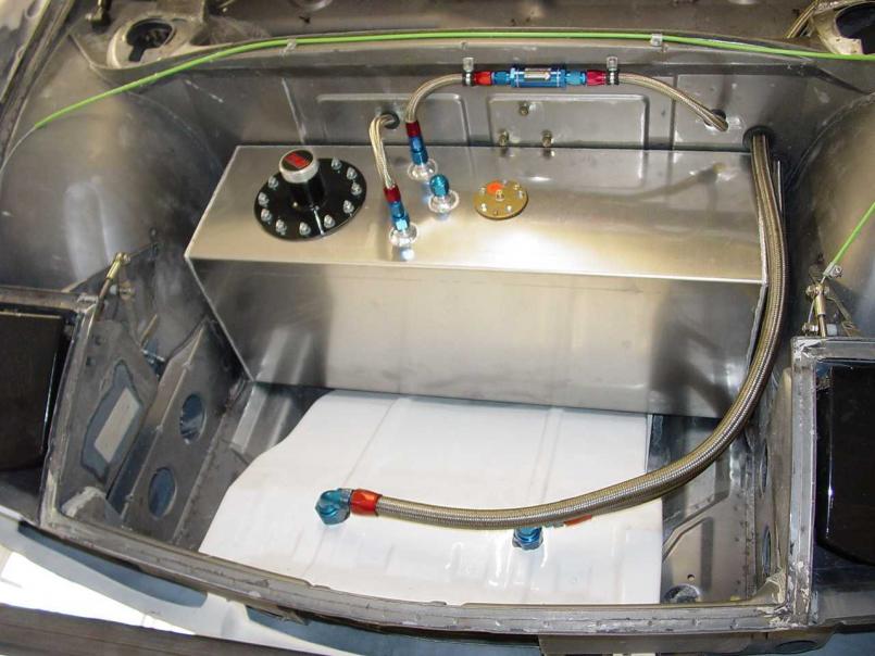

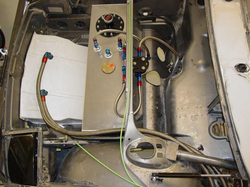

Some cool shots of my fuel system and oil cooler shroud
