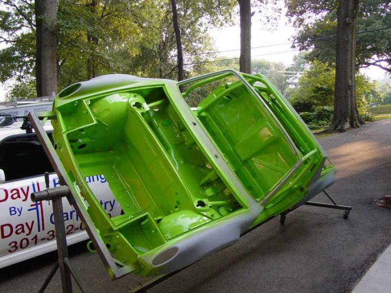

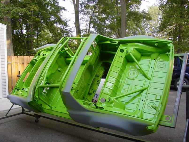

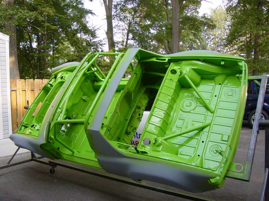

Well SHIT! I am now going to need more paint for sure.... (after mixing) 4 gallons total applied (self etch/primer/color/clear) and I have not touched the bolt on bits!!
