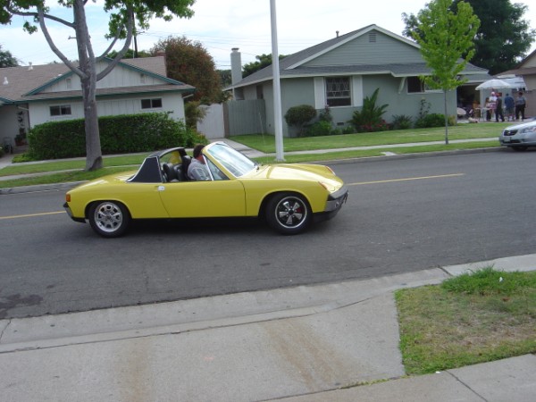

post Jul 14 2007, 08:58 PM
Born to Drive
Posts: 7,910
Joined: 26-December 02
From: Costa Mesa, CA
Member No.: 17

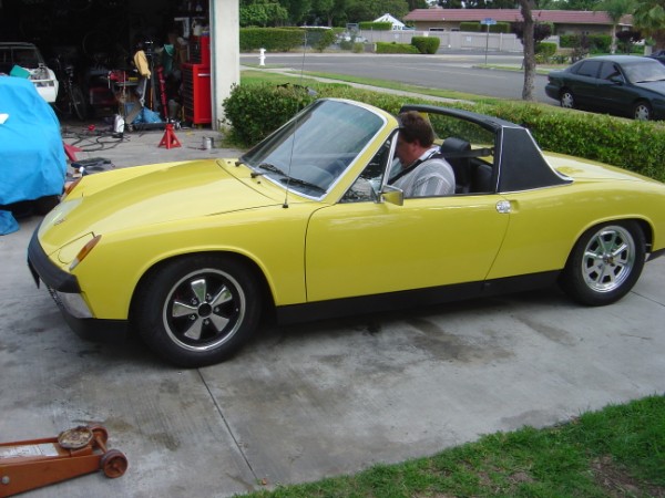

Here is the motivational shot of Ed driving off with his car this morning. It made me want to drive a 914 again. My own that is. (IMG:style_emoticons/default/blink.gif)
