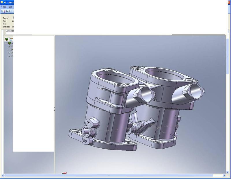

BTW- this is what it will take to feed a 300 HP daily driver, porkie headed, roller cammed MassIVe engine..
Dual stage injectors, up to 65mm of potential and solid billet
Welcome the X Terminator...
