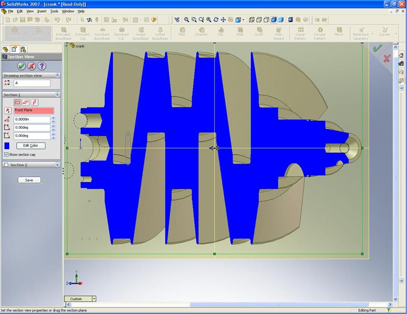

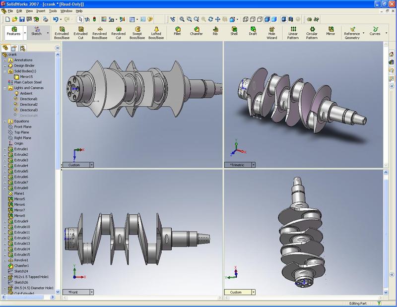

here is our billet, 4340 chromoly crankshaft.....
And the cross section
These are being made next week........
