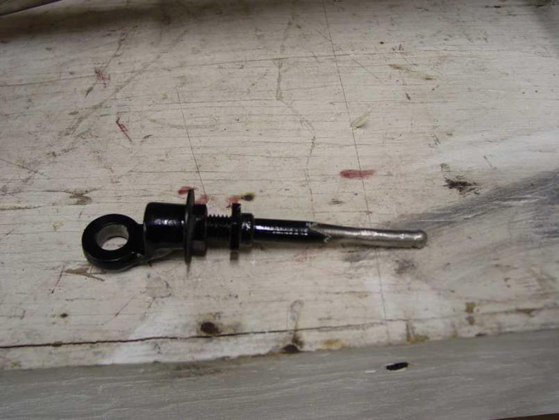

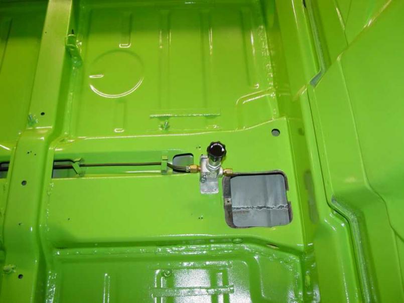

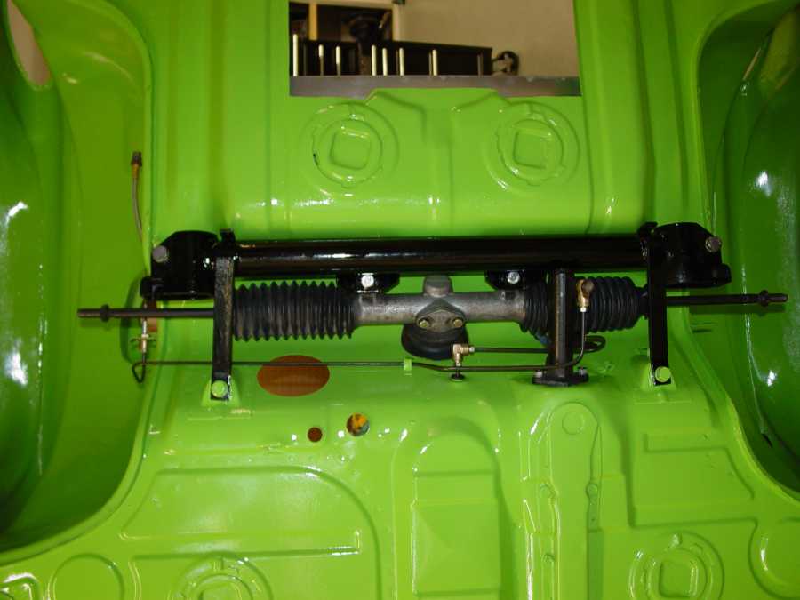

ALSO word of wisdom...the rod for braking HAS to be lengthened by about 3/4" to work with a 23mm MC and the pipes that lead in from the reseviour(SP?) bent and the DAMN thing BARLEY FITS!!! but it will fit. Brake line bending is not as easy as it looks (yes I fronted for the $40 brake line kit on Ebay....)... (IMG:style_emoticons/default/smilie_pokal.gif) I missed my pedal cluster pic but they are PURDY! having a cabinet sand blaster is DA BOMB!
