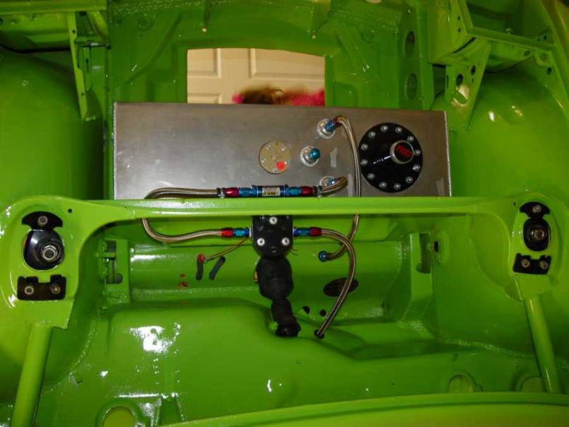

For Fuel I have a Carter rotory pump and a 15 gallon cell all lines will be AN/SS braided.

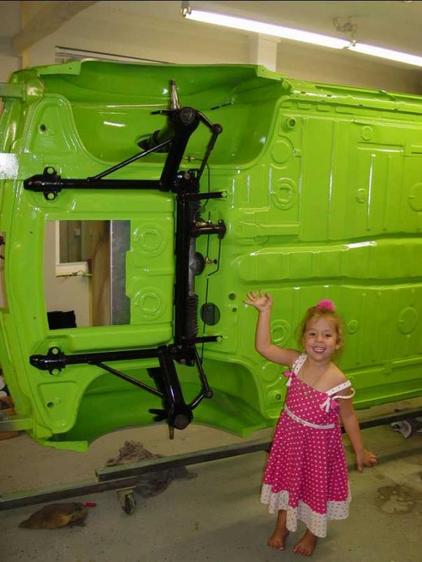

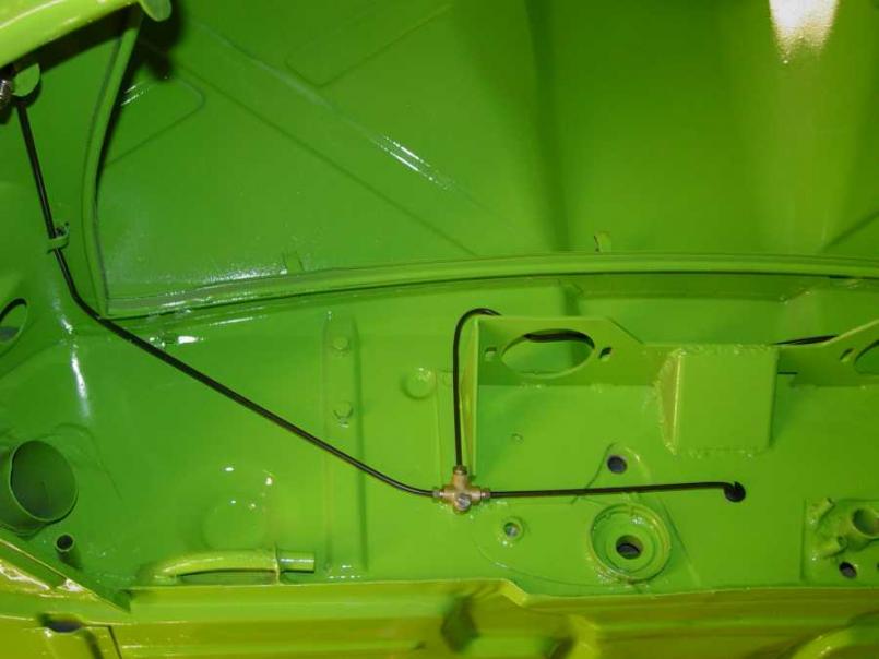

This evenings work......Sept 15th!!! good GOD MAN!! includes fitting the bushings...PIA! front suspension assembly left hand brake line, finish install of all Fuel lines to the engine bay, finish rear brake lines and of course my little 3 year old to showcase it for us! (IMG:style_emoticons/default/yellowsleep[1].gif)

degreeoff   Some cool shots of my fuel system and oil cooler s...   Jun 15 2007, 05:08 PM

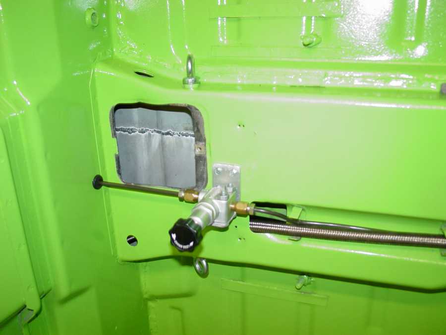

degreeoff   ALSO word of wisdom...the rod for braking HAS to b...   Jul 19 2007, 06:55 AM
