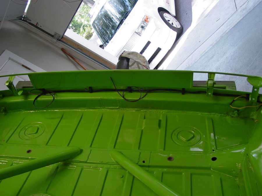

OK so the project goes on and on and on and on and did I mention on?

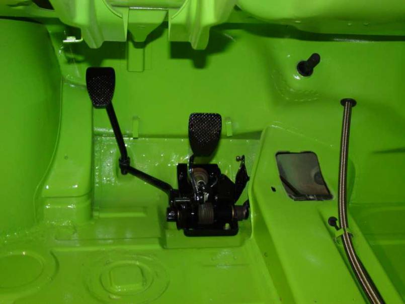

#1- pic of my pretty rebuilt pedal cluster (I know you all couldn't wait!)

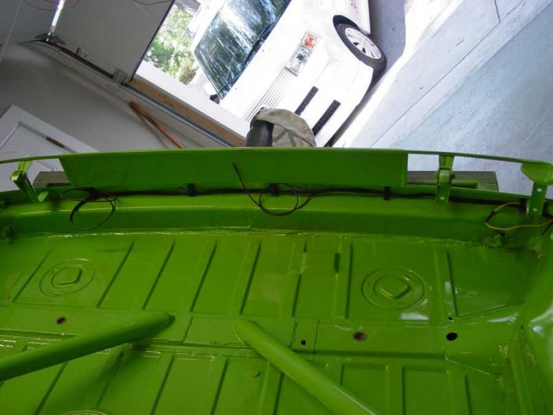

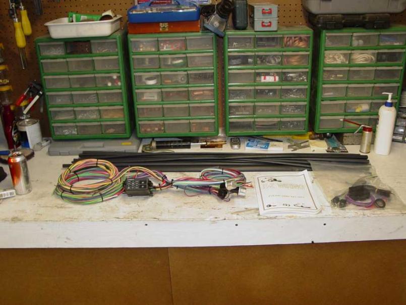

#2- pic of my "EZ wiring harness" (129 bucks? 12 circuit)

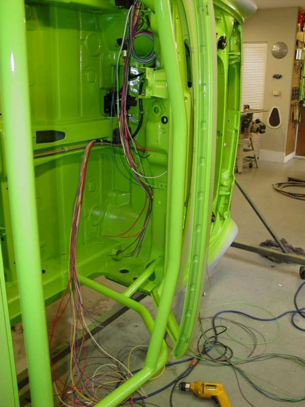

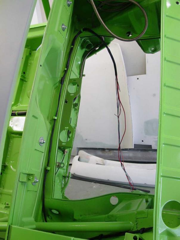

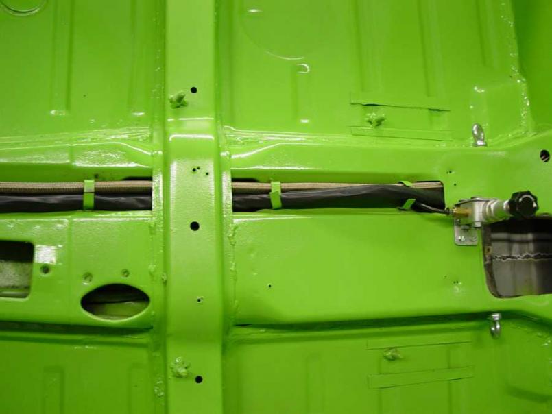

#3- Starting to install it and sort it and make a hot rod harness with an engine in the front fit a mid engined car! Harder than it looks!! As I go I slip 4' lengths of heat shrink over it and seal it up...hope I didnt make a mistake!!
#4-nice and NEAT down the tunnel....
#5-nice and neat in the engine bay.....
#6-nice and neat in the trunk....
