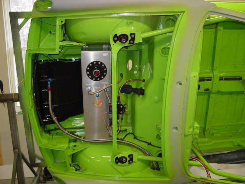

Ok last shot....I installed the oil cooler and NICE AND NEAT wiring harness, the tank, pump lines etc etc etc mounted the oil cooler shroud and damn near broke my arm patting myself on the back! (IMG:style_emoticons/default/mueba.gif)

degreeoff   fuel tank is a RCI located here http://store.summi...   Jul 19 2007, 10:49 AM
