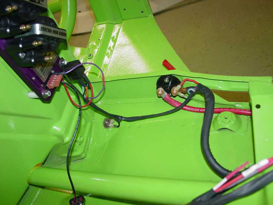

-wired the HPV ignition, interestingly enough the relay for my hot start kit worked for the relay on the HPV....WHO KNEW??..... DONE

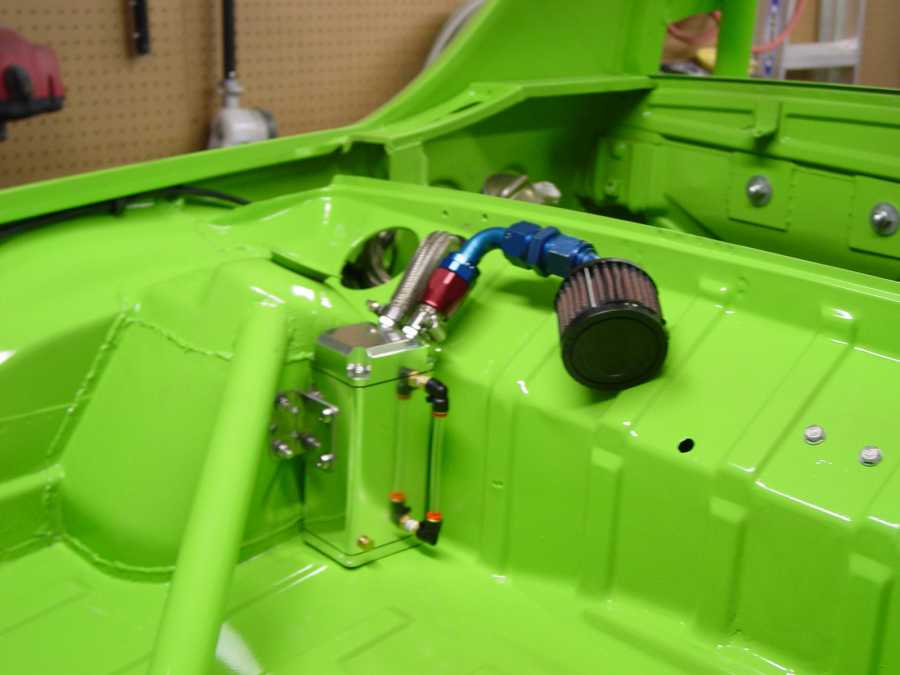

-installed the oil catch tank and plumbing.....DONE

degreeoff   OK long few days!! The dash is all wired.....   Aug 8 2007, 07:44 PM
degreeoff   OK long few days!! The dash is all wired.....   Aug 8 2007, 07:45 PM

GS Guy   Ooo - meant the oil catch can/breather you've ...   Dec 23 2007, 12:35 PM
degreeoff   Naw its some Ebay buy...and it fit fine and looks ...   Dec 23 2007, 12:43 PM
