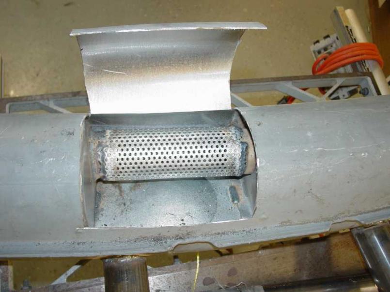

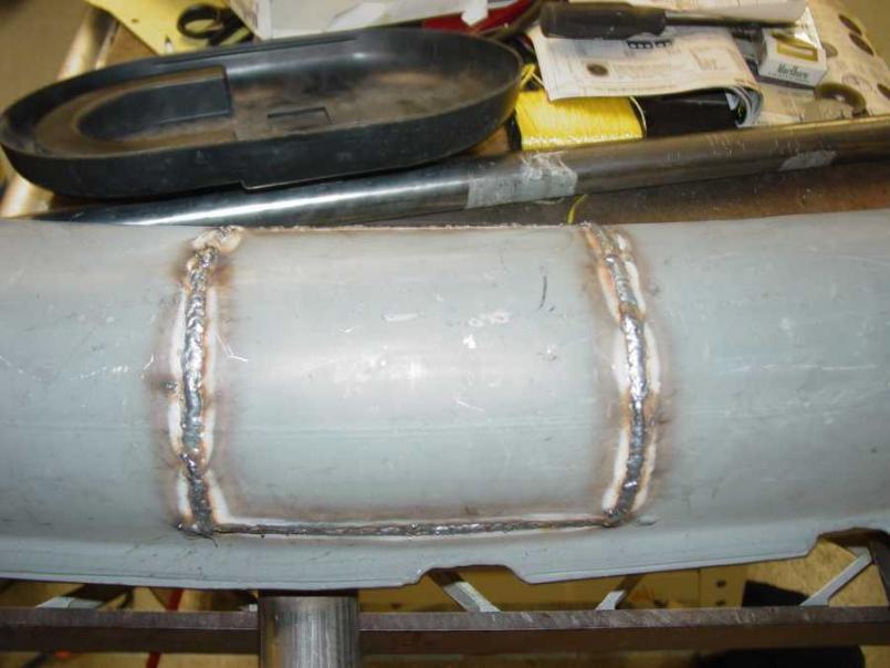

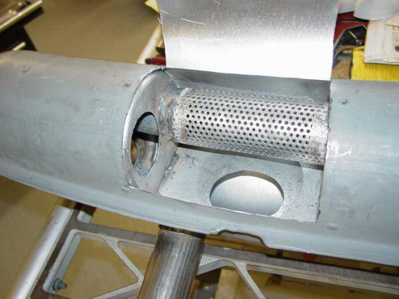

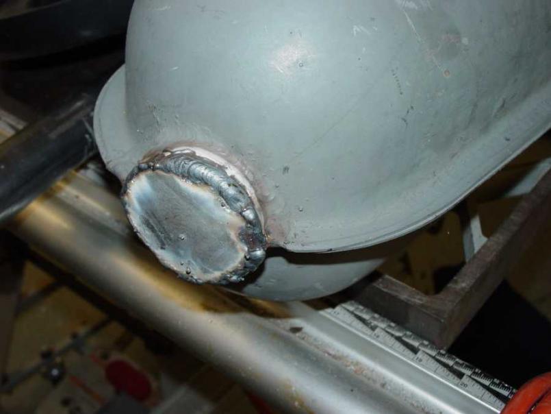

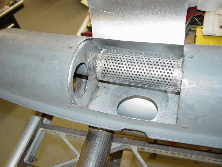

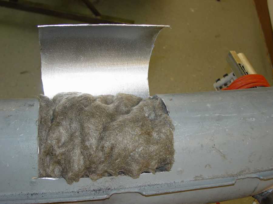

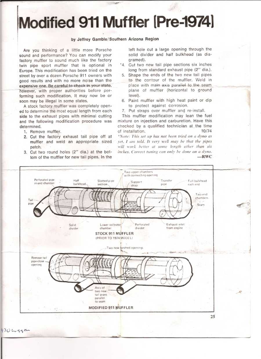

Well I just bought this early (old but new and 1/2 modified) muffler for my 914-6 conversion and after cutting off the old tail piece found this "how to" sheet inside...
Its a simple mod and easy to do IF
-you have a welder
-have a die grinder cutoff wheel and or dremel
-have a body saw and or a dremel
The 2" pipes were already on when I bought the muffler. Here it is
