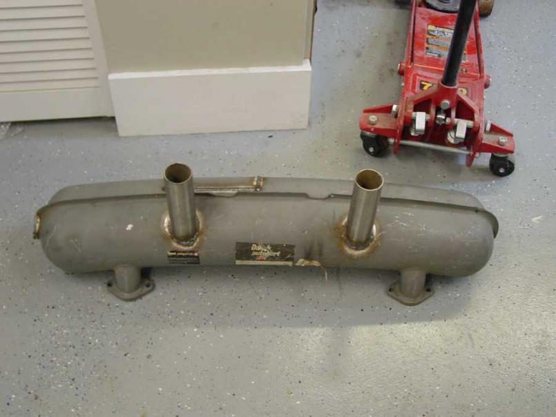

For exhaust I have European racing headers and muffler
