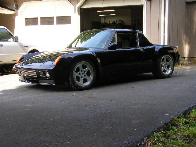

17x8 &9 235-40 front,255-40 rear.

Leo Imperial   That looks great. Are they RUF's?   Sep 25 2007, 08:03 PM
jmmotorsports   That looks great. Are they RUF's? They are...   Sep 25 2007, 08:10 PM
Leo Imperial   I love the look.   Sep 25 2007, 08:36 PM
