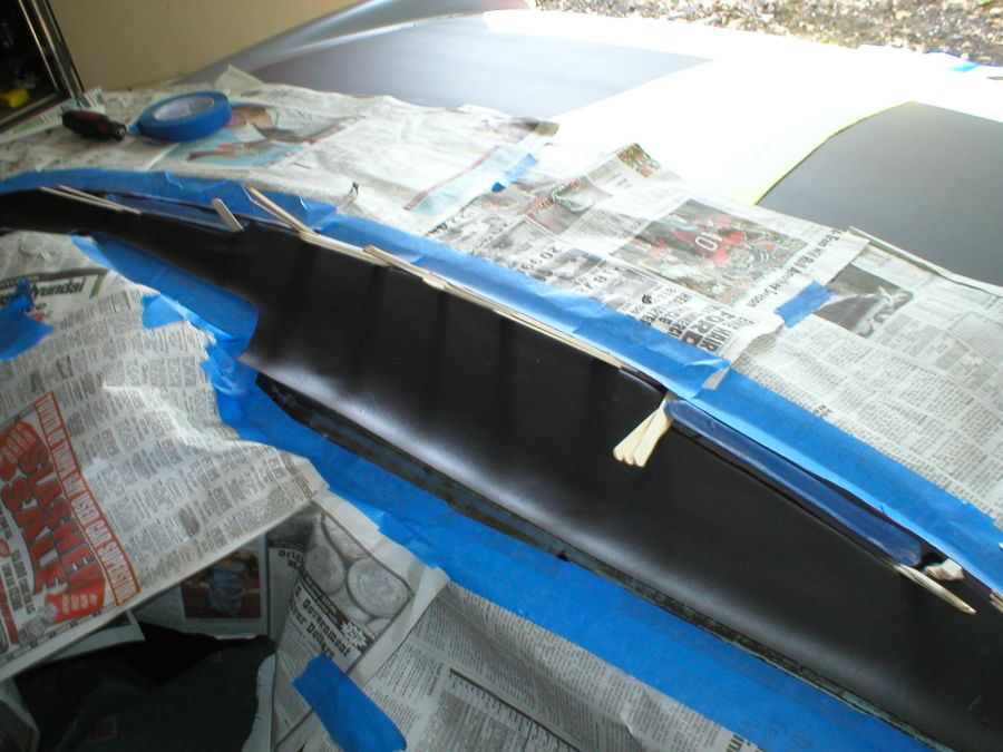

I forgot to add a post when I installed the dash vinyl back in March. Here's the link to the post showing the installation and here's what it looks like installed...
-- Rob
