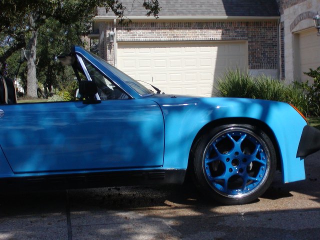

QUOTE(Jeff Hail @ Sep 25 2007, 02:30 AM) *
What about 17 inch wheels with a lower profile tire? Anyone ever run 7.5X17 in front and 9x17 in the rear? Would like to use 16 or preferably 17 inches wheels due to tire options available .What are some of the back space measurements you guys have used?
Finally got the Mallory install done and had a chance to take a pic with one of my new ATP SPA 18X8.5" bolted to the front. No rubbing issues yet, and I want to space them out about another .25-.50" after I get the 911 suspension bolted in. I have 18X10" with 285/30/18's for the rear--it's going to be TIGHT. I actually bought these already powder coated in blue--too bad it doesn't match, I'd leave them. The final plan calls for black centers with colored centercaps. LMK what ya'll think!!
--Jaybird
...see pics below
