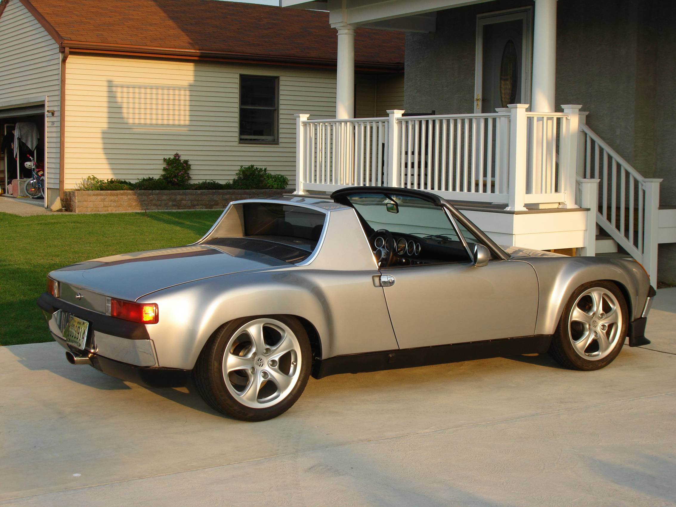

My car with AA repro steel flares and 9x17 rears, 7x17 fronts.

QUOTE(East coaster @ Oct 10 2007, 05:35 PM) *
Man I wish my car was silver. That is beautiful.
