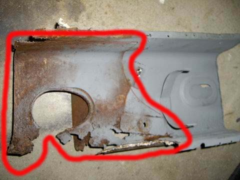

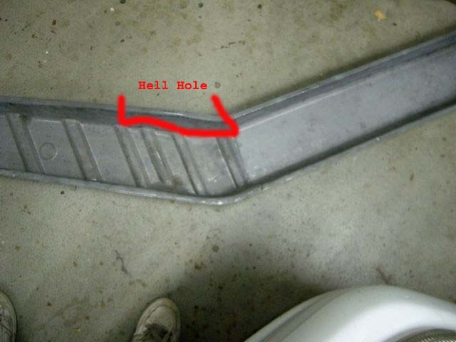

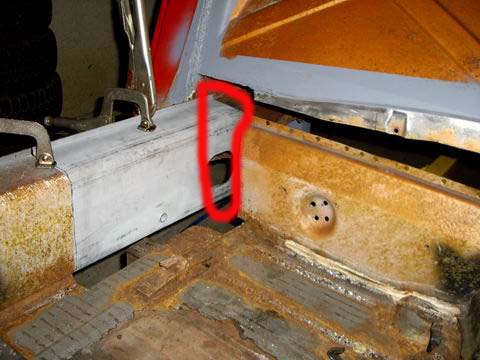

A valid PM was sent to me by Wes in reference to metal fatigue. On my previous post I may not have been clear but I will try to explain by example.
I referred to high stress/ high flex areas and double walls.
Where the inner long come's together with the rear frame rail it was double walled by the factory highlited in red.
If I were to just weld the inner long to the rear frame rail without the double wall it would be a very flexible joint and eventually fail. This would be compounded by suspension movement and engine weight and torque. This area is where the rear center section of the tub (torque box) ties into the rear structure of the vehicle. This area needs to be as strong or stronger than the factory designed it to be.
Everytime the suspension compresses this area is subjected to load. Everytime the vehicle is launched it is subject to load.
These parts are made of 18 guage sheetmetal which is not very thick. The area where the inner long ties into the rear frame rail is subject to high flex. The load of the rear section of the unibody is partially transfered to the long connection.

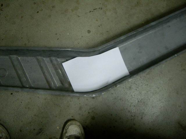

The long is a straight box and then kicks up into what is known as the Hell Hole. If rust of damage occurs at this area it will or has become fatigued with use. In a worse case scenario the car will sag. First because the supporting metal in this area has disappeared and second what metal left is supporting the weight of the car and suspension loads. It give's way. This is usually observed by a tight door gap in a very bad case of rust.
The example shown with the "paper template" would reflect the double wall at this connection. The purpose of the double wall is to spread the load at the joint into a larger area. This will reduce the load carried by the long/ rail connection at the seam/ weld area only. Because the rear rail is kicked up it acts as a lever pushing up each time the suspension compress's. The second wall controls the allowed flex in this area reducing fatigue that the long/ rail joint is subjected to.
An easy understanding would be a paper clip. A large paper clip is about 18 guage or so. If you straighten it out and then bend it back and forth it will break in two. Now take 10 paper clips and do the same thing all grouped in a bundle. It will be more difficult to bend 10 bundled and the bend area is now radiused into a larger area. If the paperclip is allowed to flex in a small area versus a larger area it will take less cycles to break. The same principle with sheetmetal applies except the long is comprised of a 3 sided box speading the load into a larger area into the wheelhouse and firewall connections.
