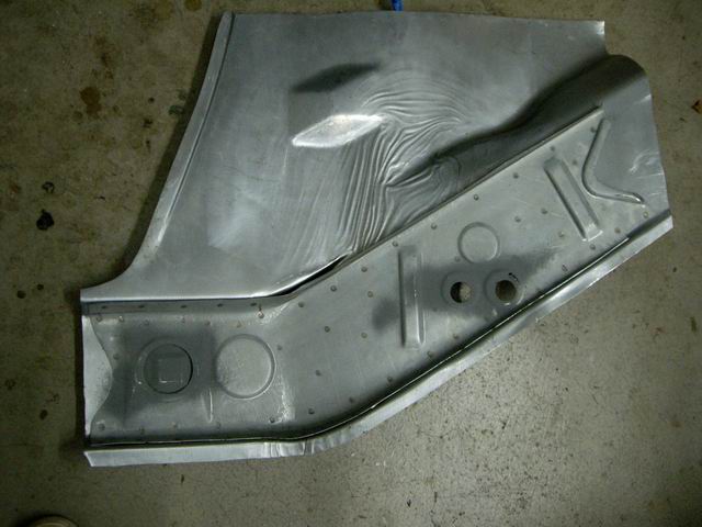

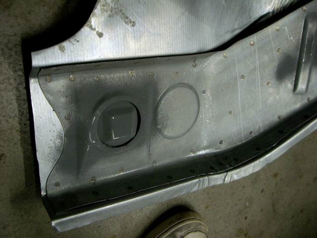

Another example of double walled panels.
The right wheelhouse assembly. This is an AA part. Notice where the double walls are? Extra layer added all thoughout the rail area which supports the the motor mounts and suspension console also.
Sorry George, pretty rough part if you ask me. If the guys used oil or wax in the dies those hidious wrinkles at the battery tray area would not be half as bad!
