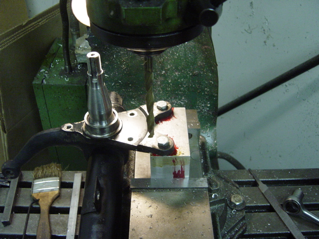

I have just finished Aaron's struts and I will share the rest of the procedure.
Here it is mounted to the jig getting ready for locating and drilling of the holes to mount the adaptor.Attached Image

craig downs   Holes drilled   Oct 25 2007, 01:30 AM
craig downs   Since the mounting holes are into the step I had t...   Oct 25 2007, 01:36 AM
craig downs   Using a transfer punch to mark the mounting holes ...   Oct 25 2007, 01:41 AM
craig downs   Tapping holes in the struts and checking multiple ...   Oct 25 2007, 01:51 AM
craig downs   All for now will add more later   Oct 25 2007, 01:54 AM

craig downs   Here is the rest of the machining The block drill...   Oct 28 2007, 04:07 PM
craig downs   Oops on the photo above the caliper is centered on...   Oct 28 2007, 04:14 PM
craig downs   Getting ready to drill the mounting holes showing ...   Oct 28 2007, 04:17 PM
TeenerTim   How about an update? Any idea of cost? Would it be...   Jan 11 2008, 08:36 AM
craig downs   Drilling the holes Tapping the holes making sure...   Oct 28 2007, 04:20 PM
craig downs   Caliper mounted to the strut   Oct 28 2007, 04:22 PM
TVRLOTUSTR3   The brake line fittings on the caliper (Banjo) a...   Jan 12 2008, 12:59 PM
craig downs   Cutting off a little of the old mounting ears so t...   Oct 28 2007, 04:27 PM
craig downs   Sorry messed up again this is the 1st time I have ...   Oct 28 2007, 04:34 PM
craig downs   Here it is installed in the car   Oct 28 2007, 04:37 PM
