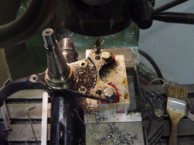

So how do you achieve this?
pretty simple. Several mockup sessions behind our favorite mexican food place on lunch breaks.... having the parts... and having a mill.
unlike 3.5" struts, a bolt on solution could not be made to fit under 15" wheels. The 3" ears interfere with the brake pads on the calipers, and spacing them out to clear would require a bigger rotor (951?) and makes 16" wheels mandatory.
Here is what we came up with
The unsuspecting victims.... (fronts and rears.... (rears are going on soon))
Cheap. Light. Newer. Gooder
one of the jigs, ready to put a step into the strut.
making a level 'step' for the adapter to lock into and a nice level/true support.
The finished products, after removing a certain amount of material. Nice and flat and true, lots of surface area (IMG:style_emoticons/default/smile.gif)
The corresponding step about to be cut into the adapter blocks. 6061 T6 Aluminum.
fast forward a few to the final products

craig downs   I have just finished Aaron's struts and I will...   Oct 25 2007, 01:28 AM
craig downs   Holes drilled   Oct 25 2007, 01:30 AM
craig downs   Since the mounting holes are into the step I had t...   Oct 25 2007, 01:36 AM
craig downs   Using a transfer punch to mark the mounting holes ...   Oct 25 2007, 01:41 AM
craig downs   Tapping holes in the struts and checking multiple ...   Oct 25 2007, 01:51 AM
craig downs   All for now will add more later   Oct 25 2007, 01:54 AM
Aaron Cox   Here is a complete pic :) Install went great - no...   Oct 27 2007, 11:35 PM
craig downs   Here is the rest of the machining The block drill...   Oct 28 2007, 04:07 PM
craig downs   Oops on the photo above the caliper is centered on...   Oct 28 2007, 04:14 PM
craig downs   Getting ready to drill the mounting holes showing ...   Oct 28 2007, 04:17 PM

craig downs   Drilling the holes Tapping the holes making sure...   Oct 28 2007, 04:20 PM
craig downs   Caliper mounted to the strut   Oct 28 2007, 04:22 PM
TVRLOTUSTR3   The brake line fittings on the caliper (Banjo) a...   Jan 12 2008, 12:59 PM
craig downs   Cutting off a little of the old mounting ears so t...   Oct 28 2007, 04:27 PM
craig downs   Sorry messed up again this is the 1st time I have ...   Oct 28 2007, 04:34 PM
craig downs   Here it is installed in the car   Oct 28 2007, 04:37 PM
