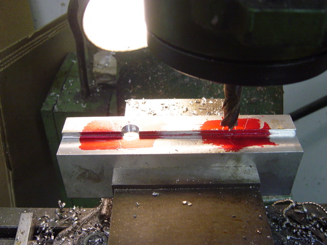

one of the jigs, ready to put a step into the strut.
making a level 'step' for the adapter to lock into and a nice level/true support.
The finished products, after removing a certain amount of material. Nice and flat and true, lots of surface area (IMG:style_emoticons/default/smile.gif)
The corresponding step about to be cut into the adapter blocks. 6061 T6 Aluminum.

Since the mounting holes are into the step I had to counter bore a pocket so I could
drill the holes

craig downs   I have just finished Aaron's struts and I will...   Oct 25 2007, 01:28 AM
craig downs   Holes drilled   Oct 25 2007, 01:30 AM
craig downs   Since the mounting holes are into the step I had t...   Oct 25 2007, 01:36 AM
craig downs   Using a transfer punch to mark the mounting holes ...   Oct 25 2007, 01:41 AM
craig downs   Tapping holes in the struts and checking multiple ...   Oct 25 2007, 01:51 AM
craig downs   All for now will add more later   Oct 25 2007, 01:54 AM

craig downs   Here is the rest of the machining The block drill...   Oct 28 2007, 04:07 PM
craig downs   Oops on the photo above the caliper is centered on...   Oct 28 2007, 04:14 PM
craig downs   Getting ready to drill the mounting holes showing ...   Oct 28 2007, 04:17 PM
